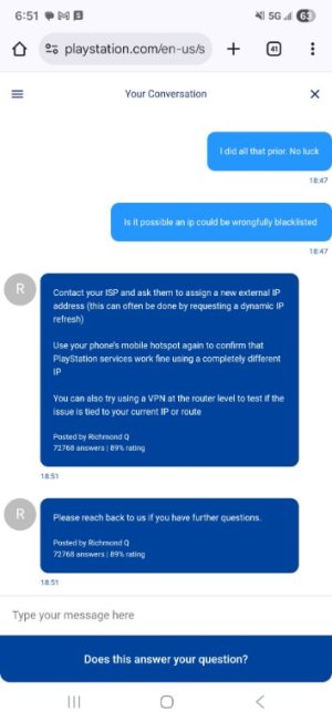

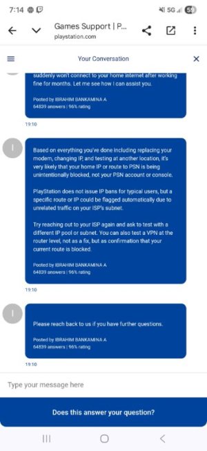

Welp he got a reply from PlayStation...

Update...so he came home from work today after talking to PlayStation and Spectrum and it mysteriously is working ..he said he's not sure why because when he talked to spectrum they were no help . So my guess is maybe PlayStation looked into his account and maybe found he was banned /blacklisted and fixed it or his ip changed from spectrum. Anyways let's hope it remains working but thanks for your quick replies and help!
