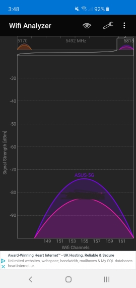

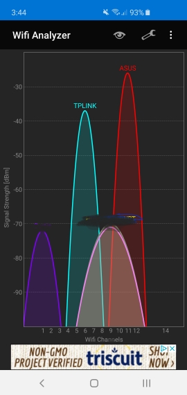

First is next to them 2.4GHz. 2nd is 5ghz a few rooms away. Its honestly not much of a difference. But every router I have seems to have a slight higher signal than these.
One example is my front yard. Is almost zero usable signal when my previous AP in the same spot it was slow but usable so I had to add a extender outside.

Hmm, 10 dBm is a significant difference. It does however look like the 225 and 245 both support mesh if I have to go that direction....
