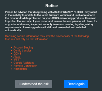

Another thing you can try is to go to Administration - Policy and Withdraw from the ASUS PRIVACY NOTICE.
Interesting. I didn't know what that would actually cost me. I... really don't think I need any of those features. At least not for the moment. I am a privacy junky so I do think I'm willing to try that option for now. Tho not sure what "Notification" and "Config Transfer" entail, those seem possibly useful.

BUT! Withdrawing ASUS Privacy Notice DID work. Woohoo. Thanks Colin.
I'm okay with those features being disabled for now, though I may want to enable WAN access someday through VPN. Does withdrawing from that prevent THAT kind of remote connection? If so, not great permanent solution. Hmm.
I think it's referring to things like AiCloud. Merlin has implemented his own OpenVPN support so it shouldn't effect that. If you need DDNS it will likely just ask you for permission again.
