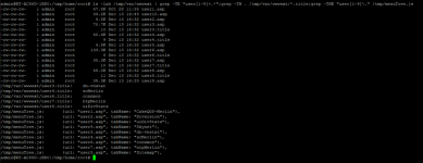

How do I make the Graphical Display option sticky? After I enable it, later when the router reboots, that option goes back to disabled, requiring me to go back into amtm to reenable it. But for the time that it is off, I do not have statistics, even if I do an Update Stats.
Update: I tried 3.23bC to see if it fixed this problem but it did not. Is there something I need to add to a config file to have this option enabled after a reboot?
Without diagnostics it is difficult to speculate on the root cause.
e.g use the following

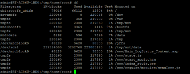

df
ls -lah /tmp/var/wwwext | grep -TE "user[1-9]+.*";grep -TH . /tmp/var/wwwext/*.title;grep -THE "user[1-9]+." /tmp/menuTree.js
before and after uninstalling/reinstall the statistics GUI

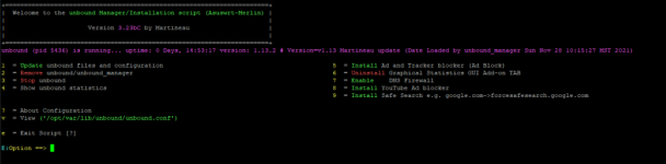

um
|  Welcome to the unbound Manager/Installation script (Asuswrt-Merlin) |
|                      Version 3.23bC by Martineau                     |
unbound (pid 19782) is running... uptime: 0 Days, 01:57:45 version: 1.13.2 # Version=v1.13 Martineau update (Date Loaded by unbound_manager Mon Dec 6 15:07:48 GMT 2021)
i  = Update unbound and configuration ('/opt/var/lib/unbound/')        l  = Show unbound log entries (lo=Enable FULL Logging [log_level])
z  = Remove unbound/unbound_manager                                    v  = View ('/opt/var/lib/unbound/') unbound Configuration (vx=Edit;vh=help)
3  = Advanced Tools                                                    rl = Reload Configuration (Doesn't halt unbound) e.g. 'rl test1[.conf]' (Recovery use 'rl reset/user')
?  = About Configuration                                               oq = Query unbound Configuration option e.g 'oq verbosity' (ox=Set) e.g. 'ox log-queries yes'
rs = Restart (or Start) unbound (use 'rs nocache' to flush cache)      s  = Show unbound Extended statistics (s=Summary Totals; sa=All; http://10.88.8.1:80/user3.asp)
e  = Exit Script [?]
A:Option ==> sgui uninstall

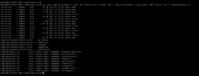

Here are screen captures while UI is enabled, and after it is disabled.
Edit: I just rebooted the router, and captured screen shots of menuTree.js right after the boot, verified it was disabled, enabled it, then took another screen shot. I also did the df command after I enabled the UI. Let me know what other info you need.
See pics above.
See pics above.
Thanks, however, my diagnostics command doesn't fully handle more than 9 user files :rolleyes:, so could you please retry
when the GUI is ENABLED, plus please post the unbound_manager Advanced mode menu
e.g.
e.g. View attachment 37775
See attached menutree.js output, and my current Unbound menu. Sorry but I cannot see how to get the Advanced menu.
