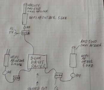

Hi everyone. We're at our wit's end trying to figure this out, so hopefully y'all can provide some suggestions to get us on the right track.
We live in a pretty rural area and get LoS internet from our ISP (stable at ~25 Mbps). This passes from the ISP's box into a central router (currently an old D-Link Dir655) that services 4 hardwired cable runs connected to Unifi outdoor wireless access points and other hardwired devices in multiple buildings in a small compound. Please see the attached image for our current network setup. We've been running this for 10 years with relatively few problems. However, the ISP recently commented that our router is super old and probably should be replaced. We have maybe 10 total devices maximum connected at any given time (wired and wifi). Our usage is mostly general internet browsing, email, wifi calling, and occasional video streaming.
We first tried replacing the existing D-Link with a TP-Link AC1900 ArcherA8. This worked for some of the network, but appeared to be unable to transmit a sufficiently robust signal along our longest cable run (~400 feet). I was also never successfully able to login to the router interface via a wired connection.
Thinking the issue might be with the Unifi WAPs, we then tried replacing the D-Link with an Amplifi HD router (also from Ubiquiti). While this did work for all of the wired connections in the network, none of the WAPs worked with this router (Ubiquiti says that our Unifi outdoor WAPs are "legacy" products and may not work with newer stuff, which makes sense).
So now we're back to square one. We'd like to get a new router that will work with our existing WAPs, if at all possible. Our budget is under $300. All our switches are TP-Link TL-SG105 units and we're not running any vLANs. We don't care too much about the wifi range of the router (it covers the road between 2 of the buildings, but is not a primary wifi access point). Our main need is a router that will work with our existing Unifi WAPs.
Any suggestions or comments on our existing setup would be greatly appreciated. Thanks in advance!
What about UCG-Ultra? It's $129.
Don't know what model your Ubiquiti APs are, may be adoptable in UniFi Network.
We chatted with Ubiquiti and they said our WAPs (they're Unifi AP outdoor 5Ghz units from 2013 or so) "may not work" with the cloud gateway. We'd rather not try something that we've already been told might not work. Thanks though!

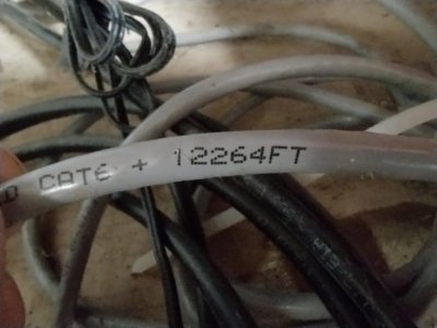

Above, i thought you said the long run was CAT5 ?
Sorry about that...all long runs are CAT6 (see attached image).
