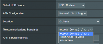

Interestingly when on the RT-N66U the line for 'Telecommunications Standards' is WCDMA(UMTS)/LTE while on the AC-1900P it says CDMA2000 (EVDO) which seems wrong. But I can't change that on the Automatic settings and it doesn't appear in the manual settings for USB WAN.
Try changing APN Configuration to Manual. Then either select a country or "Others".
Thanks Colin. I gave this a try using manual configuration as you suggested. I wasn't able to get it to work. But when I went back and switched it to Automatic, the WCDMA (UMTS)/LTE was still there instead of CDMA2000. So I tried to apply the automatic settings and that also didn't work.

After a factory reset I still was not able to get it to work initially. I manually configured the USB WAN as you showed and nothing. Then I flipped it back to Automatic, it retained the settings from the manual configuration (WCDMA UMTS LTE) and THEN it worked. I was able to pull an IP from my cell provider. Success! But it was fleeting. I put turned my WAN setting back to normal (cable modem) thinking I again had a reliable backup WAN source. Two days later I tried to re-engage the USB WAN and no dice. Same nagging issue. I didn't change any other settings besides flipping the WAN from WAN to USB. Very frustrating.
