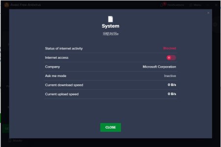

Is it mine or yours now? And what is XXXMON script I'm seeing? I don't have any scripts. Must be yours... Interesting.
Oh ahem. Cough.
Ok, here is a screenshot, I don't think this is legitimate. Let me know what you think.
According to the Avast forums, this is a bug in their AV product... this is from August 2023:
And this is why you don't let your friends use Avast. Which also means this is why your other AV products didn't detect anything... because there's nothing to detect.

Someone also changed my Eathernet adapters ipv4 dns setting to 127.x.x.x (I don't remember the exact number).
You said this happened after you killed the "System" app. As you were looking at the legitimate firewall process you probably killed your network adapter which is why you then didn't have any internet access. It would also explain why your IP address changed to 127.0.0.1 at that is the loopback adapter and was likely the only remaining network interface.
Wouldn't killing System cause a 169.x.x.x address? Also except that one time you mentioned I could surf the internet with system blocked.
I don't know exactly what you did or what you were looking at. It just seems a likely explanation based on your brief comment.

You should never ever download anything from mediafire... ever. Its haven for malware. Download apps from the actual vendors you purchase your products from. Kindle? You should be getting that software right off amazon.com... like: https://www.amazon.com/kindleapps
I concur with @ColinTaylor... killing that service probably caused a reset of your DNS entries to refer to the loopback as a fallback. You would only get 169.254.x.x IP addresses (not DNS) if your nic was set to receive DHCP, but it wasn't able to grab an IP.
I got Avast from Avast's website, I don't run pirated software if that is what you're getting at.
Typically hackers with advanced capabilities don't bother with a home network, and try to make someone's life miserable on some Win 10 machine... (unless their name is @Tech9 and they're running an RV320)
That's what I was saying in my reply of ....
Most of the time the virus is in the uefi, that's why I used diskpart to remove everything that a standard reformat would miss. Yes a virus can infect your bios. It's extremely hard to do remotely, the hack on the democratic national convention was done that way. But why would a botnet team wast there time on something like that. Yea... 🤮.
I know they were trying to get into my router because they tripped the login protection that makes you type in the weird image.
I didn't do that so if it wasn't hackers trying to get into the router who was it ghosts?
Diskpart has nothing (well very little) to do with UEFI.
Sounds like the problem has been found. Like I and many said, DO NOT USE AVAST. And for god's sake never ever ever download an .exe from mediafire!
All the other symptoms you were seeing (such as DNS being sent local) are "features" of avast and many other AV. That's how it checks your DNS lookups before sending them out.
