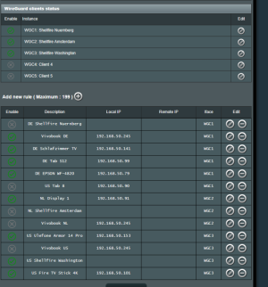

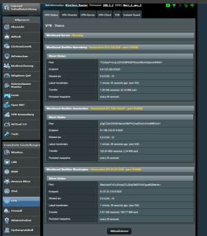

im running 3 stable WireGuard tunnel and want to use them simultaneously with different devices but it works max with 2 VPN tunnel for different clients and with every daily reconnect of my Fritzbox 6850 5G as internet modem/ wireless router, all VPN connections fail with one exception. the VPN for my Laptop, every other VPN tunnel must manually disconnected and reconnected to start working, otherwise the internet connection fails because of the KILLMON addon which works just fine. The VPN director is not working as expected.
Example:
Client 1 - VPN 1 .... works
Client 2 - VPN 2 .... works
now
Client 3 or further clients - VPN 1-3 .... does not work
and after a daily reconnect of the Fritzbox 6850 5G
every VPN tunnel fails without the VPN tunnel for my Laptop

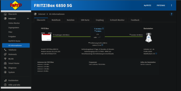

Why is your ISP modem/router reconnecting daily in first place?
That´s normal because of it´s a mobile data connection of a 5G router, it is not a mobile 5G router but a 5G able Fritzbox 6850 5G.
It´s currently connected to a LTE/ 4G mobile network only because at my current location is no 5G Network present by my ISP but it is a 5G able Fritzbox 6850 5G from AVM.

No, someone else will help you with VPN Director. I never tested it because of many variables and configuration options. I can't cover and track all the possibilities. What I see so far is you overdid it thinking your home router is some VPN appliance with unlimited capabilities. Not sure why you need 3x VPN connections. What I know is WireGuard connections don't like disconnects. What I also know is wireless Internet connections have fluctuating speed and latency characteristics making things more challenging.
