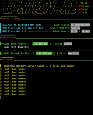

Upgraded, but getting a error...Null bad number
I think I may have found your issue for the null... please try downloading/upgrading again, and see if that fixes your issue. What would definitely fix it is making sure you run a VPN reset, because it needs to write a new format to your VPN client slot like so:
I setup 3 servers manually on my router, my Wan DNS is set to Adguard, I chose the lowest ping server method, and usually I set my provider to "other". When I set it to Nordvpn and tried out the server load option there is an error about not being able to connect to API, and "Null bad number" over and over.
Any ideas?
Did you install the latest version? v2.50 should have fixed that null error... but the underlying issue is that this is happening because I'm using a new method to get load factors using a hostname that is present in the description field when vpnmon resets the connection... I take it because you added these manually, that it probably doesn't look like this, right?

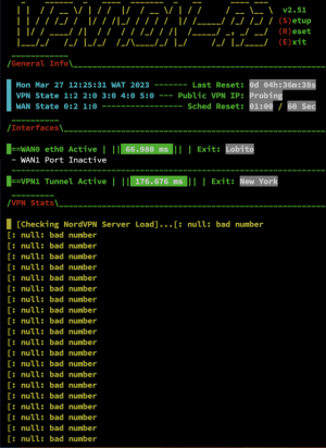

Can you send a screenshot of this error please?
After i successfully reset the connection, if i disconnect the vpn, when i try to connect again a get a configuration error...

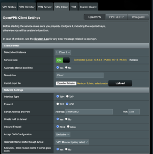

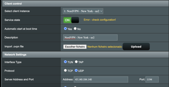

Thanks! Could you also please post a screenshot of your VPN slot/client #1, showing how its configured, and what you have in the description field?
I actually just verified that it was the entry in your description field that was causing this issue -- "Client 1" apparently was able to get around my code for some reason, and used it to try to find a load on "client1.nordvpn.com", which of course comes back with null/errors.
As soon as github comes back up (they are down hard this morning), I'll get a revision posted that will fix this issue for you!

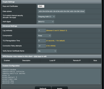

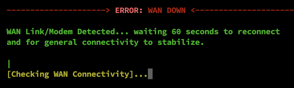

No success...Getting Error - check configuration!
Also getting wan down, even when i can access the internet no problem...
