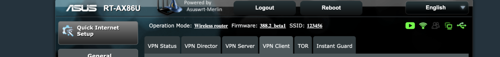

No success...Getting Error - check configuration!
Also getting wan down, even when i can access the internet no problem...
That's a connectivity issue unrelated to what we were discussing above... this means your router wasn't able to make a connection with 8.8.8.8 to perform an SSL handshake test, and/or your router was indicating that one of its WAN states was not "2" (connected). I would probably just reboot your router/modem and try again. But this is definitely not something related to the NordVPN load issue we were working on...
And the "check configuration" error is something that the Merlin firmware is warning you about. You might want to download some fresh .configs from NordVPN, and load them, save them into your VPN slots. Sounds like something in your VPN slot got borked. Or perhaps you modified the "custom configuration" section? You need to make sure these VPN connections work by sliding it to ON, and that everything works well before letting VPNMON monitor your connection, K?

Hi Viktor, steps that i took:
Defaulted the vpn connection, and created a new connection with fresh configs, and without chaging the custom configuration, after that i install the vpnmon config, fresh, set it up, and the result is "VPN1 Connection has failed. Executing VPN Reset"
When i reboot i get the "error config"....it is looping after that.

Here is what I would suggest doing. First off, leave vpnmon off for now. Go into your VPN client slot and make sure that everything looks correct. Hit the slider to "on", and make sure that your VPN connection actually starts. If it doesn't, you will need to download a new config file and set up the client slot from scratch. Only after you have verified that the VPN connection works, then feel free to start vpnmon.
I deleted the vpn profile and the vpnmon script, and started from scratch as you suggested, downloaded the new configuration, installed it and it worked without problems, did several reboots, and the vpn connection works without problems... Then I installed the vpnmon, configured it, and it worked after launching (in the sense of getting the data after launching "m1")...So I did a reset inside the script and it does the reset, however then I have the vpn error, and I can't connect again, ending in the check config error...
NordVPN, right? All vpnmon does is change the IP address in the VPN slot (if you have it configured to randomly pick new servers). Else, it just stops and starts the connection. Do you see any reason if it changes that address, for it not to work? Can you try manually replacing the IP address with another valid NordVPN address, and see if you get the same result? You should, based on what you're describing?
I outlined some steps on setting up the VPN in this post here. Are you doing anything different?
