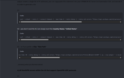

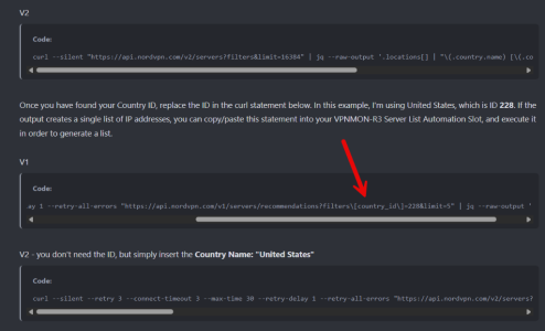

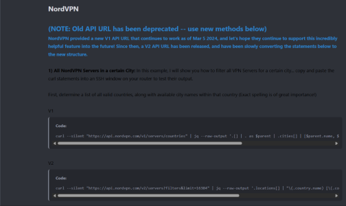

Ooops, I guess you already forgot about it. Please see the attached screenshot taken from your first post in this thread to find what I'm talking about. I guess now this is why you didn't fully understand me earlier.
Using the "R" key on the operations menu allows you to set a cron job to run a -reset at the time of your choice.
Great, this is what I was asking about. Thank you!

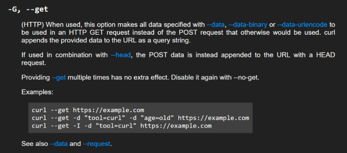

I'm not sure what what you mean... this is the URL that we're pointing the CURL statement to. Unless you meant to say that it's missing a GET statement in there as well? Technically, there is no performance advantage to adding an explicit GET statement (using -X GET or --request GET) because CURL defaults to GET automatically.
Ah! I never thought that you didn't get the right terminology I'm using...
So, "filters" within the URL string is the URL GET Parameter I'm pointing at since the very beginning. In that single URL from V1 API I told you about, you have "country_id" with the "filters" GET Parameter.
For more clarification terminology-wise on my side, when you execute a cURL command while using GET request method, it will simply append the supplied parameters (using --data) of the cURL command to the requested URL, then retrieve the output.
Please let me know if I can clarify any more. So, repeating the main old question again, did you try experimenting with the GET parameters of the URLs of the V2 API? In less professional words, did you play with the URL string or parameters?
I did briefly experiment with them, but never was able to filter the raw output.
but not really interested in partnering or accepting any offers with you (or your company).
Not a language barrier at all, and I already understood all the points you just mentioned again; maybe we both didn't clarify enough. The quote above is your answer that I already understood implicitly, so I told you -in different words- if you ever would like to partner with me for this project, I can proceed without doing any polls on my side. For the meantime, I won't start the project on my own. I hope and think it's all clear now for both of us.
