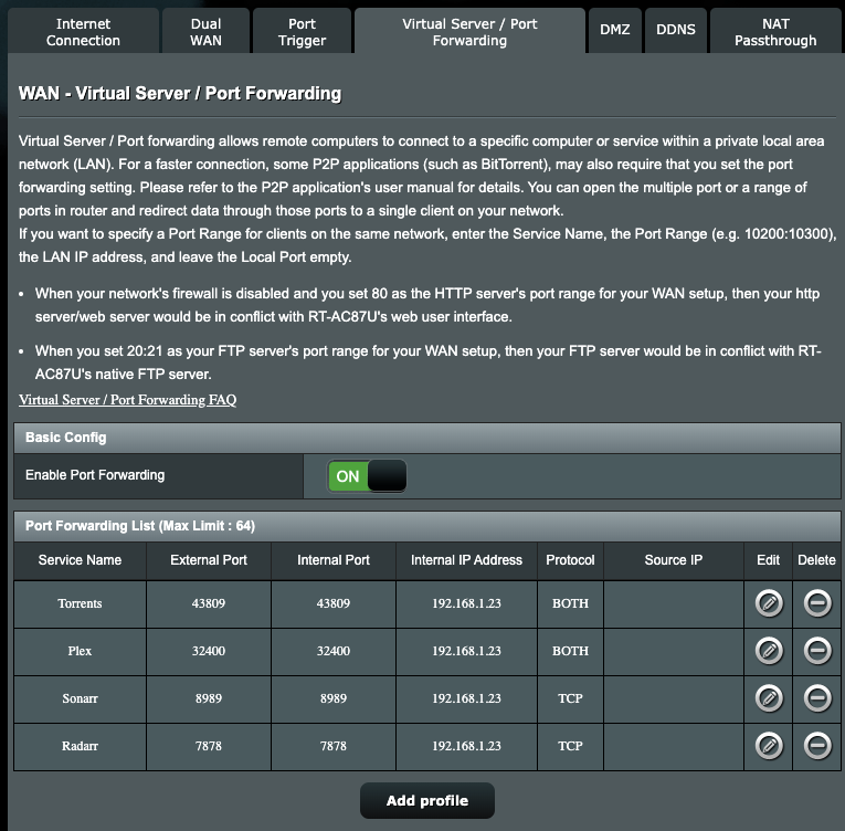

Below are some of my settings that might help with assistance, thank you in advance

I've done the Nuclear Reset, amtm swap installation (and I've started using the spdMerlin as a test to get my feet wet). I'm just about to finish the M&M settings, and I'm going to leave it at that for a week or so. Then I'll change frequency and channels for WiFi. After that I'll do Port Forwarding etc. @L&LD because I kind of need to get port forwarding going to my server, do you see this as a type of change that I should be careful and slowly rolling out. Or this is mainly for the WiFi settings?
