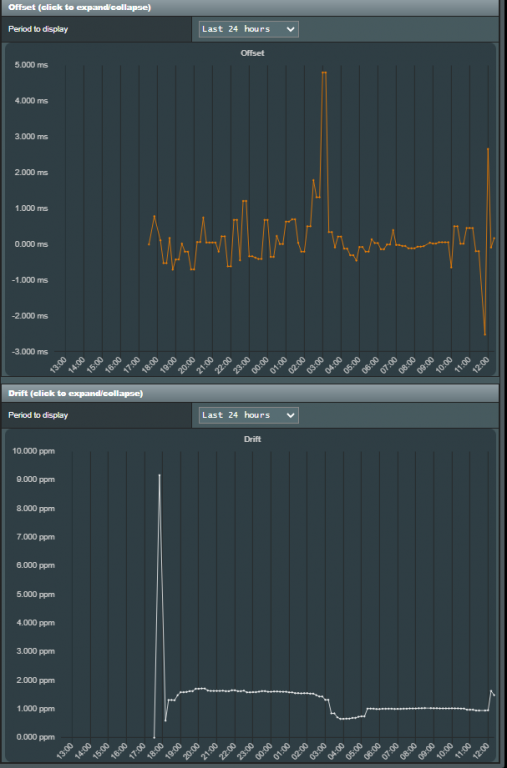

Does this look correct? I saved it as well.
And are these numbers fine by any chance?
I mean, I looked at your screenshot and all I see is straight zeros so I don't know if mine is normal or something's wrong with mine.
And are these numbers fine by any chance? View attachment 32765
They're fine. Let's just say yours looks a lot more natural then other screenshot posted above. Give it time, it settle somewhat over time, but you won't see any straight lines (unless you get really creative...)
Got it. Thanks so much.
