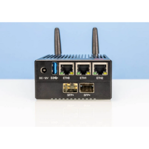

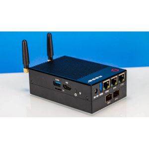

Man I love this project yet what about this thing? Seems like it would take everything to a-notha-level
  • Screenshot 2023-05-08 at 17-16-26 174.36US $ Gw R86s G1 G2 G3 G4 P1 P2 P3 P4 B1 B2 B3 Intel Mi...png
  • Screenshot 2023-05-08 at 17-16-18 174.36US $ Gw R86s G1 G2 G3 G4 P1 P2 P3 P4 B1 B2 B3 Intel Mi...png
