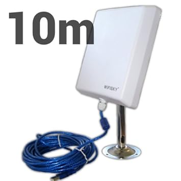

You could use this kind off antennas for wifi or why not a Ubiquiti Unifi AP AC LR
