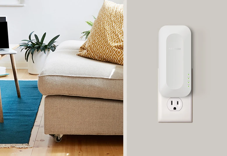

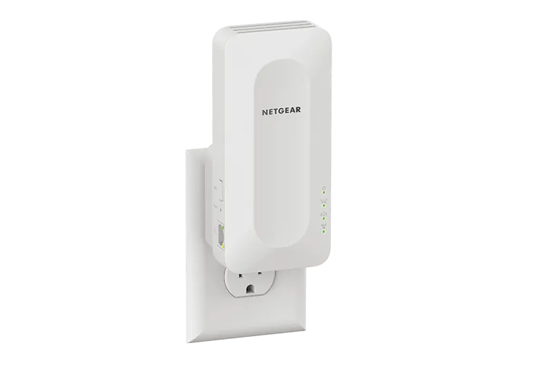

If you want AP setup 6 will be way to go but this brand stock on WIF-6 need to check
Ideally WIFI-6 lite would work with one long range wifi 6.
You need these to setup complete network. You can decide if this setup fits or move to router and extender which still be similar price but coverage needs to analyzed though WIFi-6 top end router claims 3k-4k Sqft coverage reality may be half or even less depends on obstacles.
Multiple extenders on each room or where need more coverage
