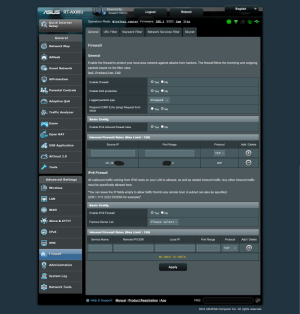

Enable the firewall rules portion of the page. Put 10.6.0.1 in the IP field, then enter your port in the port field and select UDP. Hit apply and you're done.
That rule does not make any sense. Wireguard udp tunnel would be between the client public ip and the router and the port should be opened in the INPUT chain, filter table. Why would you setup this port to access to your LAN??
When the tunnel is setup your wg clients would communicate out of the wireguard interface and be forwarded to lan, or wan or wherever you wish, but surely you need all ports and both udp and tcp to work.
You say that this fixed your connection issue and I cant argue with that, but I don't believe that rule fixed anything. It must have been something else.

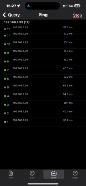

In my case,
Asus router: enable IPv6, passthrough,get an IPv6 of WAN.
cable modem: IPv6 , port forwardinging to asus wan port IPv6.
And that’s all.
WireGuard setting, as asus official site.
PIC: my iPhone connect with WireGuard to my intranet. Ping NAS IPv4 address .
