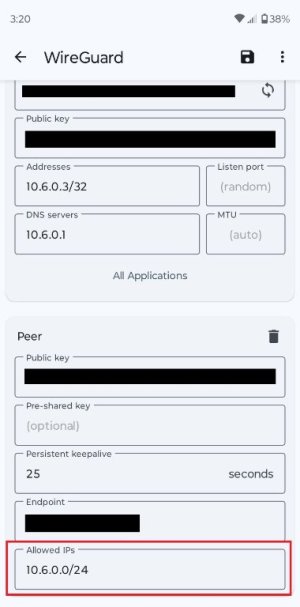

The Wireguard client installed on the smartphone doesn't have an option for Allowed IPs.
The Android Wireguard has an Allowed IP's section.
Ofcource, its not using the tunnel anymore if AllowedIPs (client) is limited to wg subnet. All other data would not use the tunnel at all. Im assuming the OP want internet via his router as that would be the only reason left.
Yep, not having internet traffic through the VPN tunnel to the router's WAN port would be an issue. 😆
The problem appears to be with the Access Intranet option in WireGuard Server. When disabled while Wireguard clients might not be able to access other intranet clients they can still access the router and any USB device attached to the router. At least that's what happens for me on a RT-!X86U Pro.
That's correct. And you (as the client) have the right to enter whatever you want there. If your smartphone falls into the wrong hands, it will lead to access to your router and other devices on your network. The only difference for me is that instead of a smartphone, I'm forced to use a VPS, which, by default, is in the wrong hands.
