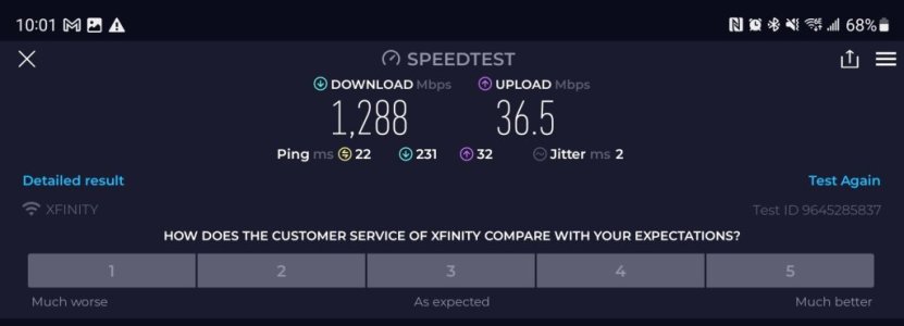

I'm finding that WMM APSD increases the speed on both my 5/6 Ghz networks by double. 600Mbps to 1200Mbps. From everything I'm reading, this feature is commonly explained to decrease network performance. Any idea why it would help so much?
In my scenario I'm performing a speed test from my zfold4 connected via 5Ghz and 6Ghz.
Just wondering your thoughts?
Let me know if you need any more details.

The x2 factor (2x600=1200) could suggest the difference is due to a x2 bandwidth change... if you fix the bandwidth to 80MHz and use a non-DFS control channel, does the speed stay steady over time? I'm ignoring the WMM APSD observation.

Agreed, enabling the feature bounces the radios and restores the 160mhz bandwidth, but over time radar drops it back to 80. Probably will fall back down after a while of having APSD enabled.
Yeah, I agree with you guys.
I did some testing and it must be improving the bandwidth by temporarily setting 160Mhz. APSD does seem to be a red herring. I inevitably found the bandwidth dropped with APSD enabled as well.
