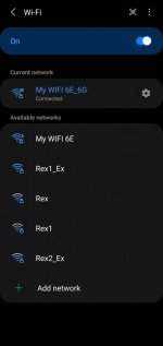

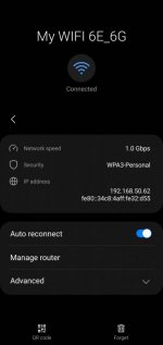

Alright guys. I got wifi 6E working right now. Fully stable and fast. I believe the progress could be a little bit tricky since I did not expect it to work like this lol. But it works and I have pictures below. My GT-AXE11000 came today, however, like the others, I could not connect to 6ghz band as default. After thinking for 2 hours, I tried to do this.
- Enable Dual-band Smart Connect 2.4ghz + 5ghz option in Wireless => General. (you know what I mean)
- Tri-band Smart Connect does not work (current 42026 firmware)
Your wifi should be [your wifi name]_6G which is good. No need to edit it. Leave it be lol. But still, you can change to whatever you want. Must be different from the other SSID. In other words, your router needs a separate SSID for 6ghz band in Dual-band Smart Connection mode. WPA3 works great.
Now you will have 2 SSID, the main 2.4ghz + 5Ghz one combined. And the other is 6ghz band which is now fully functional. The range is kinda short because it is what it is. But the speed is incredible fast with a little lower latency, but higher jitter due to the range.
Finally, you're welcome. Wifi 6E go bruh bruh bruh. I made a review on Amazon as well. It might show up after 2-3 days.

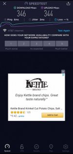

Is your internet speed only 340Mbps?

With the same range, you get faster wifi speed. Devices join the 6G band almost instantly. The wifi signal could be less, but the speed is twice faster than 5G at the same tested spots. Less ping/latency, but a little higher jitter. The internet speed is much faster, with 5G and 6G bands doing speedtest at the same time, 6G can maintain more stable + higher download/upload speed. The microwave next to my router (about 2ft) no longer interferes the wifi signal, only 5G affected. My house is small so don't ask me why a router is next to my microwave lol. My area has 15 wifi ssid, they sometimes reduce my upload speed and range drastically. My Echo keeps connecting to my neighbor's wifi because of Amazon sidewalk. Even my wifi is about 10ft close to me, Echo chooses the farest wifi ssid to connect and refuses to connect to my own ssid. My wifi is jammed a lot. Not only that, they have wifi 5 and 6 also in my area. The jam is much worse now since 2020. I really want the Wifi 6E to work with my desktop PC also, however, I have to use cable for now because I usually transfer files between my WD 18TB connected to the router and my PC. Until Wifi 6E is enabled on Win 10, my PC still sticks to the ethernet cable. Couldn't get AX210 to work, so I have yet tested it. Atleast the only way right now is Galaxy S21 Ultra. But based on my usage recently, the lower channels give a faster speed than higher channels (currently 37). Still, the range is bad but the wifi speed still maintains at max. The wifi speed only reduces when I'm about 60ft away. Even only with 1 sign bar, the speed is still crazy good. I can even watch 4K HDR videos with 1 bar of signal. Cool right?
