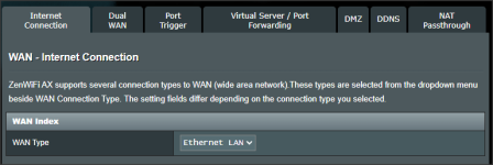

I found out that you CAN do it by choosing Lan Port 1 instead.

Yes!. I have 1GB/1GB FIOS internet service and was getting 800M/200MB with wired LAN. After I enabled the Dual WAN and switched my Primary WAN to LAN Port 1, I am now getting 800MB/800MB!!!!

I am plugging my xt8 to Verison ONT. but, instead of plugging 2.5/10 WAN port, i am using plugging LAN 1 to ONT after enabling Dual WAN
