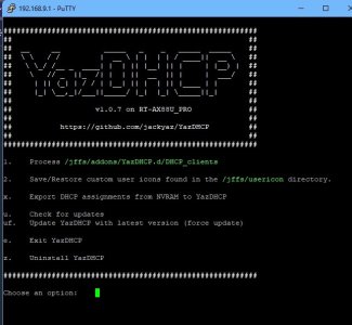

Darn, I had to run a CLI command with .sh appended on another script so thought it might work here.
I have (just now) installed YazDHCP (j7) from amtm, which installs 1.06, ran it, exported my current DHCP assignments, exited amtm, then ran @Ripshod CLI command and it worked to get to 1.07.
sh /jffs/scripts/YazDHCP develop

On the latest "1.0.6" version, YazDHCP has the option to back up & restore custom user icons, and using this feature includes backing up the custom client names.
Apologies if this has been answered, I did a search within this thread but could not find a specific response. I’m using 1.0.7 develop on the 3006 Beta on an RT-AX88U Pro.
As regards custom client names (old custom_clientlist in /jffs/nvram which I emptied to avoid conflicts), you note above that backing up the icons also backs up custom client names.
Is this backup of the custom client names in the same zip file as the icons (and can it be extracted and edited for re-upload/restore?), or is there a separate file where custom client names are stored (and that can be edited if need be)? Thank you 🙏.

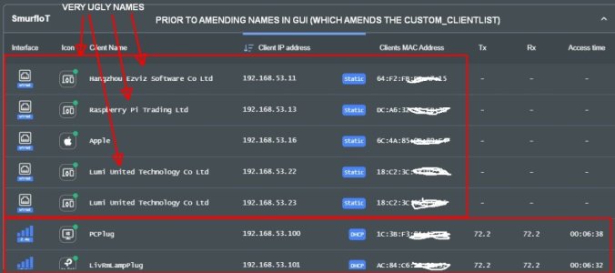

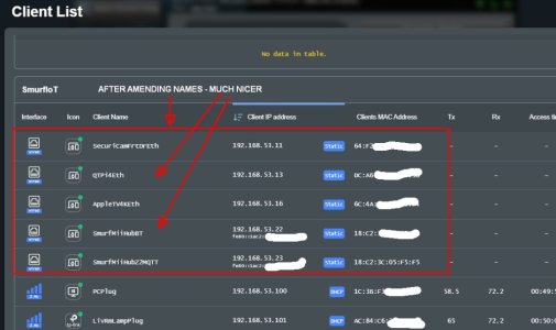

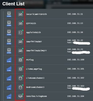

Also noted in that thread is that if you add (actually amend) a Custom Name in the GUI (Network Map, Client List and look at the contents of custom_clientlist straight away, you will see it only adds TWO ">>" after the device type number; however a reboot changes (corrects) that to five ">>>>>".
The reason I mention this here in the YazDHCP thread is that if you add custom client names for devices in your VLANs either:
  1. via the GUI accessed via "Network Map, View List, Client List or
  2. manually, by editing the custom_clientlist file located in /jffs/nvram,
then when YazDHCP (which is only intended for the manual assignments for the Primary Network) backs up Icons, (via the unassumingly-named "Back up Icons" button) it also backs up the custom_clientlist including the entries you just added for the VLANs.
I think this is pretty neat, in fact I think it is absolutely great! I checked the NVRAMvar_custom_clientlist.TMP file located in the CustomUserIcons_date.tar.gzip in /opt/var/SavedUserIcons and sure enough the VLAN assignments were all there. So in conjunction with either:
3. the (relatively new) 3006 FW option of manual MAC/IP/Hostname assignments in the VLAN GUI or
4. adding the dhcp-host=MAC,IP,Hostname via the dnsmasq-x.conf.add option discussed here (or using dnsmasq scripts),
the system is actually complete for VLANs too.
I am sure this is all old hat for the folks who do this for a living, but I'm not one of them, so I'm chuffed to bits this actually works out. Thank you @Martinski, very much appreciated.

You can also amend custom_clientlist in WinSCP (it is in /jffs/nvram), which is what I do.

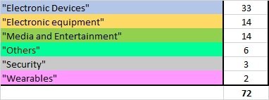

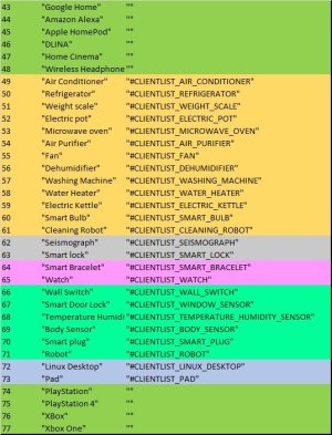

Ok, this is probably more for interest than anything else, but maybe someone poking around in the contents of custom_clientlist one day will be able to see what the device type that has been assigned is. I am not sure if the assignment in the client_function.js kindly pointed out to me by @dave14305 in the current binary blob (can't believe I just wrote that) gets updated regularly or not but anyway, here is the simplified table.
I used the section in client_function.js called var custom_icon_list_api = {, ; currently these are between lines client_function.js#L3875 to client_function.js#L4341 inclusive.
Some minor comments/observations:
  • The ASUS tag is the only one not in Caps, presumably that is by design as it does need translating?
            {tag:"#CLIENTLIST_MACBOOK",text:"<#Clientlist_Macbook#>"},
            {tag:"#Clientlist_ASUS_NB",text:"<#Clientlist_ASUS_NB#>"},
            {tag:"#CLIENTLIST_SD_CARD",text:"<#Clientlist_SD_Card#>"},
  • It seems that #PRINTER, #ROUTER AND #IPCAM are the only devices translated directly, all the rest are prefaced with "#CLIENTLIST_ (or nothing, for Media and Entertainment). The mapping table (var custom_icon_db_translation_mapping = [) does however show these mappings, so they just seem to get mapped to existing devices i.e. #Clientlist_Printer# and Device Types 2 and 5 respectively. The #NAS seems to get it's own mapping to #NAS_SERVER ("#CLIENTLIST_NAS_SERVER").
{tag:"#PRINTER",text:"<#Clientlist_Printer#>"},
{tag:"#ROUTER",text:"<#Device_type_02_RT#>"},
{tag:"#NAS",text:"<#Device_type_04_NS#>"},
{tag:"#IPCAM",text:"<#Device_type_05_IC#>"}
  • None of the Categories "Media and Entertainment" have a Device translation; nor do devices "iMac", "USB", "Camera" or "Kindle". I am sure there's a good reason for this.
  • Maybe a wee typo here?
        "warables": {
            "title": "Wearables",
            "translation": "#CLIENTLIST_WEARABLES",
XLSX File on Dropbox [EDIT, refer latest file in the link in the post below], happy to share for editing an offline copy (maybe someone else can host it) but I didn't want to let every person and their dog edit it online.
Thanks again to @dave14305, you're all over this, I'm just curious.
[EDIT] Sorry the first Pic is probably illegible, just too big, so the forum uglifies it. See other extracts, plus the XLSX.

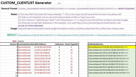

OK, so as a follow-on to the above, just for fun, I created a custom_clientlist generator as an extra tab in the XLSX v.1, I am sure it is full of bugs, so use with care. Cells are password protected w.e.o. input cells. [EDIT] XLS now has tabs to copy/paste original dhcp_staticlist and custom_clientlist data and place in columns for ease of data transfer and input into dnsmasq-x.conf.add files.
I have found custom_clientlist modifications to be reasonably robust, but nonetheless, use at your own risk.
What is nice about this, in conjunction with the Device_Type Table, if you use dnsmasq-x.conf.add for manual assignments (as an alternative to the limited GUI in GNP VLANs) it will populate the VLAN client lists in the Router GUI with the Icon associated with the device type you assign. YazDHCP already does this for the primary network.
[EDIT1] I update the file from time to time, after improvements or added icon files. Download the latest custom_clientlist generator here. See also above screenshots for various Icon Types etc.
[EDIT2] If you use Merlin with amtm, I suggest you use YazDHCP for DHCP reservations and saving, importing, exporting IP/MAC assignments as well as icons. It is easy to use, well written and obviates the need to fiddle around with files which have a propietary, undocumented and difficult to use syntax with lots of "<<<<" and ">>>>" characters.

  • Source 2: On the Router, in www/ajax/extend_custom_icon.json; this is an extension to the ones in client_function.js.
The XLS provides device numbers for a combined set from both sources; currently 131 # icons. Use these numbers in your custom_clientlist file.
Hey guys, seem to be having some issues. Had to reset my router from scratch, reinstalled this script.
But when I go to the LAN DHCP page, then click on "import from csv", select the file....nothing happens?
I.e., no reservations show up?
Try installing the latest (aka the "develop") version - v1.0.7.
/jffs/scripts/YazDHCP forceupdate
