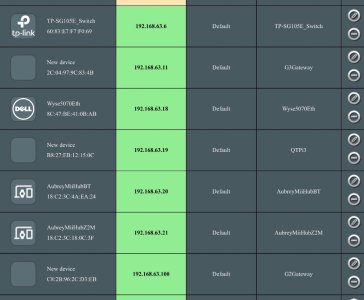

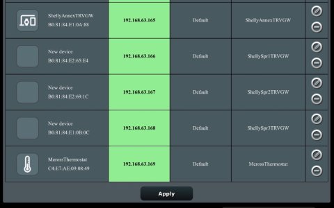

After quite awhile without needing to add any new clients I finally went to add some last night and discovered that doing anything in the YazDHCP GUI isn't being saved, i.e. if I want to add new clients I have to SSH in to the router and edit the files directly. I switched to the Dev branch to see if that would resolve the problem but it did not. All the file permissions look like they're correct, and YazDHCP is running fine so I'm not sure what the problem is as it's never been an issue before.
@Seth Harman That's a strange one. Not seeing the same. No problem removing, adding clients to YazDHCP v1.2.4 on a RT-AX86U Pro running Asus-Merlin 3006.102.6. I do not have any AiMesh nodes. In my quick test, removed a client from the main LAN and YazDHCP properly indicated the removal. Added that client back and YazFi properly indicated the addition to the main LAN pool. YazDHCP also properly updated a fake MAC address client added as a test to the main LAN pool.
As indicated in the following screen capture of the /jffs/addons/YazDHCP.d/ folder, files have been getting updated (todays date/recent time).
