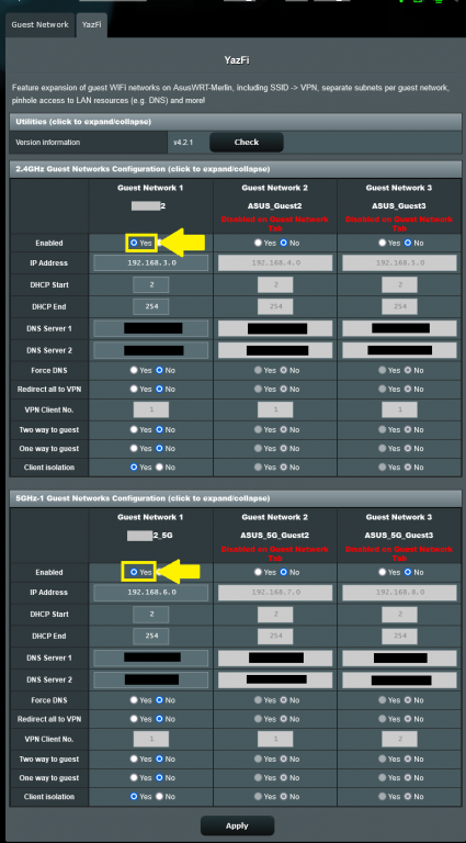

Click on the YazFi tab and post that screen which will show the YazFi configuration settings. The screen capture you posted isn't the YazFi Configuration GUI. It is the Asus-Merlin Guest Network GUI. If you do not see a YazFi tab in the Guest Network section that indicates a possible YazFi installation problem.

Hey again
adding screenshot from yazfi UI page
send me a dropbox upload link I will send you diagnostics from yazfi and the password to the tar file.
Hey again
