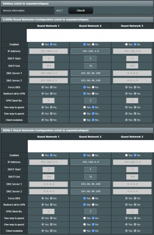

Ok, so I have the Guest Wifi 2 up and running but seem to be stuck on this one: I am trying to direct all traffic on Guest Wifi 2 via VPN 2, with the exception of 2 IP's - .2 and .3 (which are assigned by DHCP as per this post - https://www.snbforums.com/threads/y...inc-ssid-vpn-client.45924/page-32#post-473403).
I've been playing around with a number of settings but can't seem to get it to work.
YazFi settings
VPN 2 details (NordVPN)
DNS Config - Exclusive
Policy rules (automatically added)
2.4GHz Guest 2 192.168.3.0/24 VPN
5GHz1 Guest 2 192.168.6.0/24 VPN (P.S. i think there is a typo with the '1' being added?)
With this setup, all clients are routed via VPN2 and all clients can access the internet.
If I change redirect all to VPN to 'no' then add the following policy rules to VPN2, no client can access the internet
Guest 1 192.168.3.2 WAN
Guest 2 192.168.6.3 WAN
I've tried combinations of Force DNS = 'no', redirect all to VPN ='no' and DNS config = 'disabled/relaxed/strict/exclusive' but I all I can seem to do is end up with all clients on Guest Wifi 2 going via my WAN/real IP, or all via the VPN...
I'm sure that it's some simple setting/configuration that I've overlooked... any help would be greatly appreciated!

you'll need to use a userscript (https://github.com/jackyaz/YazFi#custom-firewall-rules) for this. enable redirect to VPN for the guests in YazFi, then follow the below
create
/jffs/addons/YazFi.d/userscripts.d/myscript.sh
Remember to make it executable with
chmod +x /jffs/addons/YazFi.d/userscripts.d/myscript.sh
Contents:
#!/bin/sh
iptables -I YazFiFORWARD -i eth0 -o wl0.2 -d 192.168.3.2 -j ACCEPT
iptables -I YazFiFORWARD -i wl0.2 -o eth0 -s 192.168.3.2 -j ACCEPT
iptables -I YazFiFORWARD -i eth0 -o wl1.2 -d 192.168.6.3 -j ACCEPT
iptables -I YazFiFORWARD -i wl1.2 -o eth0 -s 192.168.6.3 -j ACCEPT
if your WAN interface isn't eth0 then replace accordingly
then apply YazFi settings (option 1 CLI or Save in WebUI)
hopefully I haven't missed anything!
