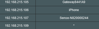

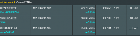

After upgrading my AC86 to 386.2-4 the latest version of YazFi no longer assigns a DHCP in from the subnet 192.168.3. 0/24 subnet range.
Instead the devices connecting to guest network 2 get assigned an IP from the router's primary DHCP subnet.
The VPN I want the guest devices is up and connected.
Devices are connected to the SSID for guest network 2.
Rebooting the router, removing YazFi completely then reinstalling doesn't fix the problem.
Thought it might be a problem with the rules coming to late in the boot cycle but even connecting a device to the guest after the the router is rebooted and stable.
This is what I get when I go directly into YazFi and ask for a list of connected devices:
INTERFACE: wl0.2
INTERFACE: wl0.2
SSID: ControlVPN2a
HOSTNAME IP ADDRESS MAC
Unknown A0:C9:A0:5B:88:5F
Unknown 00:16:6C:A2:40:39
Unknown 00:D0:2D:84:41:A9
Unknown 2C:61:F6:B6:A8:E3
diagnostics please and a copy of syslog from a reboot up to where devices are connected but the wrong ip

Here you go:
/tmp/YazFi.tar.gz.enc with passphrase lBRrZIfldaXDuyixLA7M9F0pKfwD7AaU
I have the gx.enc file but I can't attach it. What do I need to do so I can open it and send you a screen shot of the contents?

ive looked through the diagnostics and i can see all of the necessary firewall rules are missing
if you run YazFi over SSH and option 1, do you get any errors that don't make it to syslog?
I will have time this weekend to check. I reverted back to 2-2 which resolved the issue and also a couple of other nagging issues I had while on 2-4.
