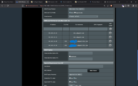

The router has been reset to factory settings. One router in the house without any access points. Everything works wirelessly. I would like to know if these DNS settings are correct for WAN and LAN?

No, leave the LAN DNS servers blank. Your clients will then use the router for their DNS and the router will forward the requests to the upstream DoT servers.
This is assuming that you actually want to use DoT rather than traditional DNS.
You may want to remove your private AdGuard TLS name from the post.
I'll leave it as it is now, if I understand correctly.
