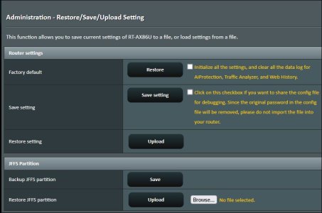

Flash Merlin a second time and then GUI Factory Reset. (start fresh)

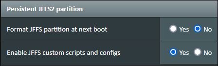

Edit: Enable JFFS custom scripts, under Administration, System tab.
You may need to put a check in the box next to "Restore" (Yellow text field)

Got it sorted guys and I feel a bit stupid but it won't be the last time. I never realized you had to keep the jffs custom script button enabled all the time. I would just access it when needed to go into putty and amtm into the router and switch it off.
