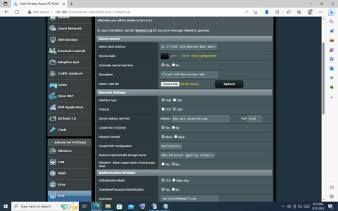

Hi I'm attempting to step up an OpenVPN Asuswrt-Merlin firmware but I'm having trouble Service State keep getting this error msg (Error - check configuration). Under Keys and Certificates i copied and pasted the Ipvanish certificate in certificate authority. I'm not sure what I'm doing wrong? Any suggestions. See Attachments

Check the System Log, find the error message, change what it complaints about, try again.
Your problem is in configuration settings no longer supported by the new OpenVPN versions. The error is in vpnclient log messages.

Can somone help me? I'm trying to create a OpenVPN Tunnel and then I can choose which devices I want to go thought the VPN or bypass the VPN but can't seem to configure the open client to the internet. I'm having trouble Service State keep getting this error msg (Error - check configuration). I had done this a while back but lost all the setting when I had to upgrade the Asuswrt-Merlin firmware. Is there a way I can attach the system log, and someone can tell me what I need to to fix this error.

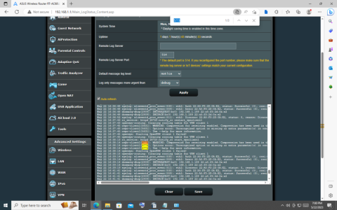

Colin went to the system log clicked control -f in the find I entered the ovpn-client 5773 it gave the screen shot I i'm sending.
What I'm I removing the 5773 or keysize 2.6.3. I'm I removing it from the system long? I'm confused.
