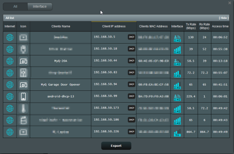

I'm having trouble with my guest network with YazFi on my AX88U. My LAN is 192.168.50.0/24, and the guest network is supposed to be 192.168.2.0/24
I connected my phone, laptop, and a smart garage door opener to the guest network to test it out. My phone initially gave an error that it couldn't get an IP address from the Geust SSID (DHCP), but after a few tries it connected and got an IP on the guest network, 192.168.2.x. My laptop also got a guest IP. The clients showed up under the YazFi settings as guest clients. Shortly after, I checked my phone, I'm still connected to the guest network SSID, but my IP has switched to a LAN IP of 192.168.50.x, same with my Mac, it's on the guest SSID but it's getting a LAN IP 192.168.50.x.
Clients seem to switch between the two subnets while still being connected to the guest SSID. The smart garage door opener is showing up under the "network map" which you can see is the MyQ-20A and the MyQ Garage door opener (Hub + Sensor). The garage door opener has not shown up under the YazFi settings as of yet.
The client "Android-dhcp-13" is my phone, and it shows up in both the network map and the YazFi connected clients list simultaneously. You can see the MAC address ending in A3:08 on both.
My Mac is connected to the Guest SSID and showing up in network map, and is getting a LAN IP of 192.168.50.x
I think I figured out the Mac at least. I had a static IP set in DHCP so the router probably saw the MAC address and assigned it to the LAN. I removed that and I think that took care of it. However, I can't figure out the garage door opener, why it shows in the network map (it has the wifi icon that looks like it is on the guest network) and not in the YazFi connected clients list. The door sensor that you pair with the hub after you connect the hub to the wifi also shows in the network map list, but it's icon appears to be on the main wifi, without the guest icon.
I can also access the router GUI login from my phone and use the asus router app while on the guest SSID

Thanks, I'll check out your links. But my phone wasn't switching between the network SSIDs, I could literally go into the wifi settings on my phone and see that I was connected the the guest SSID but still had an IP address for a LAN client. No DHCP reservation for my phone was configured. And I could still access the router GUI login and use the Asus router app on the guest ssid.
Also, that doesn't explain the smart garage door opener. It doesn't show up under the YazFi GUI page at all. It doesn't show up in the YazFi CLI either.
The only place I see the garage door opener is on the network map. And there are two devices, one shows with the little guest wifi icon, one does not. The hub (MyQ-20A) gets set up through an app, which I joined to the guest wifi, and then you link the door sensor, which looks like it somehow just joined the LAN network.
I also just joined some Blink security cameras to the guest network (reconfigured through the app. Had to hold down the reset button on the blink station, connect to it through the app, and then sign in to the guest network.) It does not show up as connected to the guest either.

I believe it is the Guest Net 1, just the first button on the left in the GUI. Won't switching to 2 or 3 break AI mesh? I have the main router downstairs and a lot of the smart home devices are upstairs and need to connect to the AX58U I have set up as an AI mesh node. If I use the other guest networks, won't they all try and connect to the router downstairs and have a really poor connection. Router downstairs is on the opposite side of the house, and garage is on other side, another floor up. So wifi won't reach it very well from the main router. Thanks for the advice tho. I may have to test that to see how it works.
