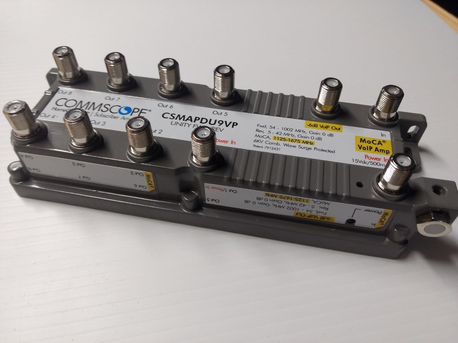

Thanks for the responses, luckily Amazon has a decent selection of MOCA-compatible amps/splitters and I've ordered this one.
Interesting that your new amplified MoCA splitter is quoted to have the frequency range:
  • Operating frequency band: 54 - 1002 MHz.
in the text about it, which is MoCA 1.1, while in the picture it shows 1125 - 1675MHz., which is MoCA 2.0.
If you get the one in the picture, it should work fine for you *smile*. Hopefully, they just forgot to update the text, and the ones that they're shipping are MoCA 2.0.
Enjoy!
I think the operating band refers to the frequencies affected by the amplifier (that would be the incoming/outgoing signals rather than the MOCA signals). At any rate, I found a PCT MOCA splitter/amp on eBay which has the same form factor as my existing splitter, so I won't have to worry about any paint touchup (and it's also cheaper), so I've decided to cancel the Commscope.
Yes, those are for the amplifier in the specific bands only. The MOCA band is passed not amplified. Let's hope they send you the one pictured.
