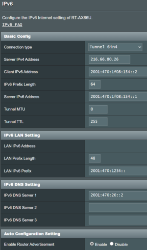

Can you show me a screenshot of tunnelbroker ipv6 settings without identifiable info? Just as a reference, to make sure I'm doing it right.

Here you go (I don't normally run with this enabled anyway). In this example 2001:470:1234:: is the new /48 prefix.

It is asking for a prefix not an address. Once you put the prefix and apply, the LAN IP should show up in the non-editable "address" field above. I'm assuming it picks 1.
