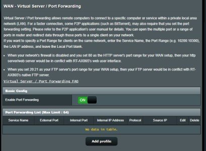

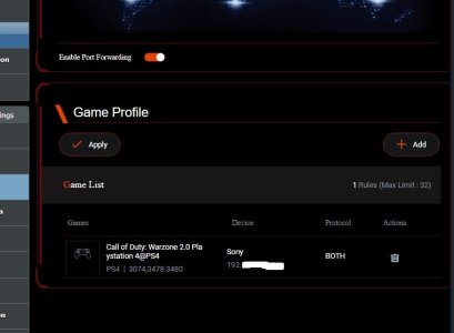

The last reset was around a week ago and I have altered various settings to set up port forwarding/game mode - Not sure if I've done it correctly as it shows on the pc but not on the app? Qos was enabled but now off as it made no difference.

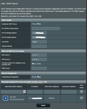

PS4 settings I have a static ip set and via the router I have set it to google servers as they appear to be fastest.

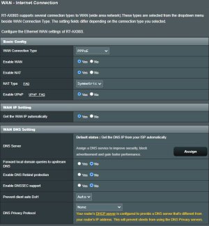

Hope that helps somewhat and I've attached a few settings pics for you... Capture.JPGCapture2.JPGCapture3.JPGCapture4.JPG ;)

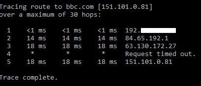

Run a traceroute to bbc.com and paste the results here.

So going back to dynamic IP made no difference?

Don't use the port forwarding (at all).
