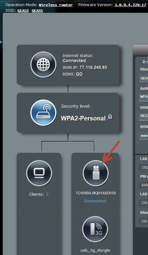

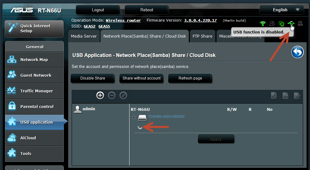

The HD seems to have been recognized, but i not mounted. Besides, I'm told that "USB function is disabled"...
On the next screenshot you can see the label of the HD, but "unmounted"...

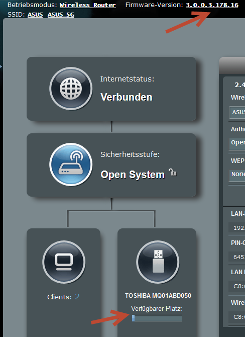

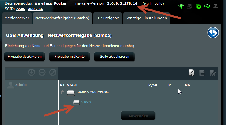

Flashing back to 3.0.0.3.178.16 Beta 2 Merlin everything is as it should be:
Strange...
