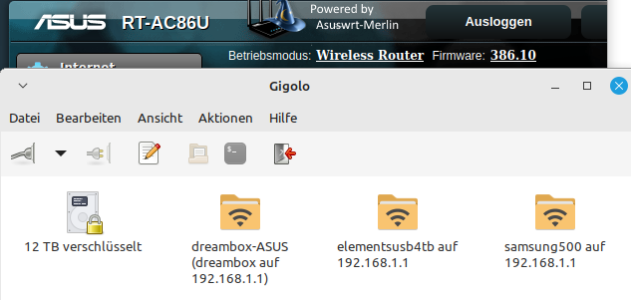

Thank you so much. You have made my day. I copied the smb.conf to /jffs/configs and my HDs are listed individually again. Then I unplugged the usb stick and rebooted and they are still there. Great :)
