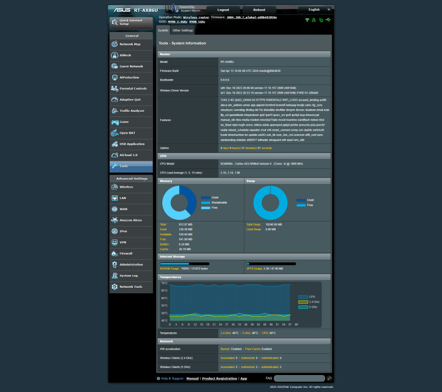

This looks awesome! I did notice that the temp graph didn't fill in the last column between 57 and 60. Thank you for all of your hard work @RMerlin!!! Checked everything I use and seems all is running smooth as silk.
Is that because "60" is the same as "0" of the next minute? 🤔

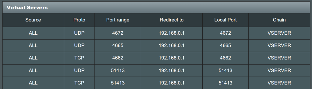

1.Here is a list of unknown ipv4 port forwarding i never set.屏幕截图 2024-04-14 115444.png

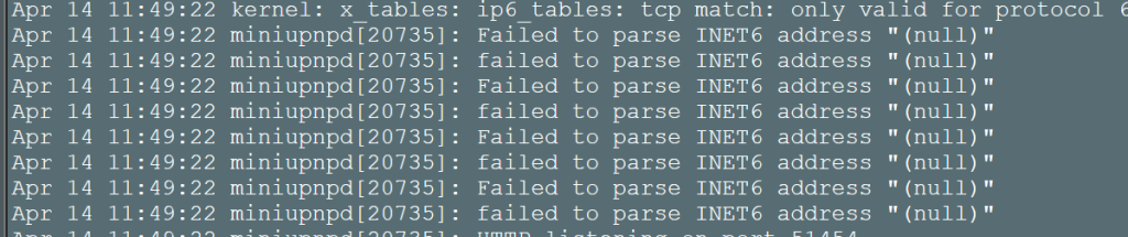

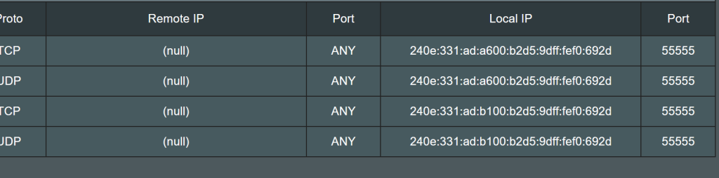

2 ipv6 upnp failed, its qbittorrent client

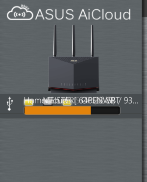

3 the icons for lan devices overlap on aicloud page

Upgraded to Alpha2 from the latest Alpha1. Running stable for more than 10 hours. Nice new System Information page! Thanks RMerlin and other devs!

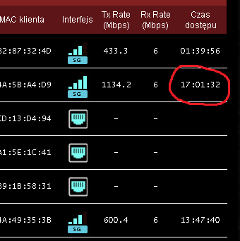

For alpha 2, Network Map, Interface Mode, Wired can not sort using Clients Name --> Access time headings. Sorting OK for 2.4 and 5 GHz interfaces. Note: yellow highlight bar sits under column headings for Wired and over column headings for 2.4 and 5GHz interfaces.
