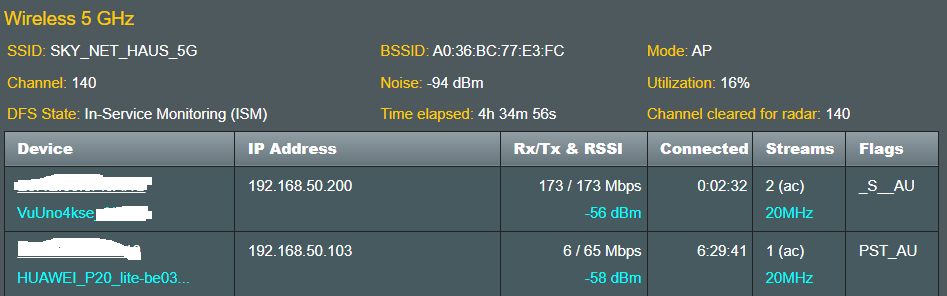

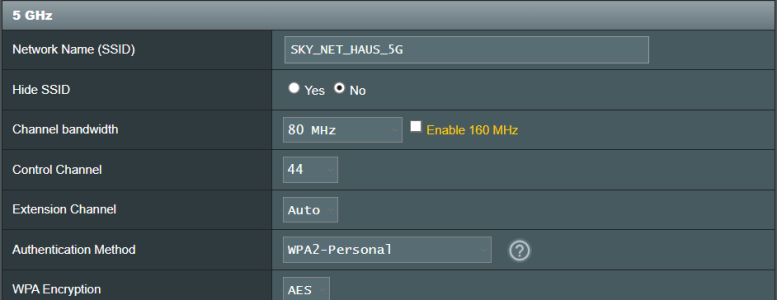

Wireless log don't reflect the wireless Wifi 5GHz setting, I don't have 140 channel in my 5GHz channel list, the maximum is 128. ?
I have channel set to 44 non DFS channel but wireless log indicate 140 DFS channel and my channel bandwidth is set to 80MHz but i get only 20MHz in wireless log.

Wireless log don't reflect the wireless Wifi 5GHz setting, I don't have 140 channel in my 5GHz channel list, the maximum is 128 ?
Its likely a setting or geo region thing. That's to say you DO have a channel 140 but it may not be user selectable due to what I said. I'm not sure if residential routers are held to the same FCC rules as industrial but it sure appears that way. EU is always allowed to run more power.
Its likely a setting or geo region thing. Thats to say you DO have an channel 140 but it may not be user selectable due to what I said. Im not sure if residential routers are held to the same FCC rules as industrial but it sure appears that way. EU is always allowed to run more power.
I have channel set to 44 non DFS channel but wireless log indicate 140 DFS channel it's strange .
I can't say I know for sure but it could have been a crowded channel, or some sort of auto adjustment for performance or interference. Make sure if you want to use specific settings you turn off all the "auto" options for freq. settings.
This must be a bug. Wireless driver or UI.

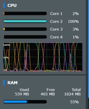

Un abnormal CPU activity

Login with SSH and post the output of:
top -bn 1 | head -20
ASUSWRT-Merlin RT-AX86U_PRO 3006.102.4_alpha2-g774261a90a Mon Mar 24 21:57:18 UT                                                                                        C 2025
asus@RT-AX86U_Pro-E3F8:/tmp/home/root# top -bn 1 | head -20
Mem: 700448K used, 318064K free, 3376K shrd, 14564K buff, 136244K cached
CPU:  0.0% usr  0.0% sys  0.0% nic 75.6% idle 24.3% io  0.0% irq  0.0% sirq
Load average: 3.38 3.13 3.04 1/198 5715
  PID  PPID USER     STAT   VSZ %VSZ CPU %CPU COMMAND
  921     2 asus     SW       0  0.0   0  0.0 [wl0-kthrd]
 5841     1 nobody   S    27316  2.6   0  0.0 dnsmasq --log-async
 5842  5841 asus     S    25100  2.4   2  0.0 dnsmasq --log-async
 5411     1 asus     S    20628  2.0   1  0.0 wred -B
 2918     1 asus     S    20392  1.9   3  0.0 conn_diag
 5401     1 asus     S <  19392  1.8   1  0.0 dcd -i 3600 -p 43200 -b -d /tmp/bw                                                                                        dpi/
 2935  2918 asus     S    18944  1.8   2  0.0 amas_portstatus
 2602     1 asus     S    18944  1.8   3  0.0 roamast
 2968     1 asus     S    17992  1.7   3  0.0 amas_lib
 2562     1 asus     S    16140  1.5   0  0.0 networkmap --bootwait
 2391     1 asus     S    15868  1.5   1  0.0 /sbin/netool
    1     0 asus     S    15316  1.5   3  0.0 /sbin/init
 2940     1 asus     S    15264  1.4   2  0.0 cfg_server
 2388     1 asus     S    14284  1.3   1  0.0 nt_monitor
 2534     1 asus     S    14204  1.3   3  0.0 httpds -s -i br0 -p 8443
 2539     1 asus     S    13816  1.3   2  0.0 watchdog
Everything looks idle but a peculiar amount of I/O activity (24% which is essentially 1 of 4 CPU cores). If you repeat that command every few seconds, does the output change much? Ideally you’d see the top processes with high percentages under the CPU% column, eventually.
Nothing change
Mem: 703572K used, 314940K free, 3508K shrd, 14568K buff, 137432K cached
CPU:  0.0% usr  2.3% sys  0.0% nic 73.8% idle 23.8% io  0.0% irq  0.0% sirq
Load average: 3.03 3.04 3.01 1/200 11344
 2940     1 asus     S    15264  1.4   0  1.1 cfg_server
11343 11153 asus     R     3324  0.3   0  1.1 top -bn 1
 5841     1 nobody   S    27316  2.6   3  0.0 dnsmasq --log-async
 5411     1 asus     S    20628  2.0   2  0.0 wred -B
 5401     1 asus     S <  19392  1.8   1  0.0 dcd -i 3600 -p 43200 -b -d /tmp/bwdpi/
 2935  2918 asus     S    18944  1.8   0  0.0 amas_portstatus
 2602     1 asus     S    18944  1.8   1  0.0 roamast
 2968     1 asus     S    17992  1.7   2  0.0 amas_lib
 2534     1 asus     S    17048  1.6   2  0.0 httpds -s -i br0 -p 8443
 2562     1 asus     S    16140  1.5   3  0.0 networkmap --bootwait
That kind of CPU usage sometimes happens for a short period right after a reboot and/or after a FW upgrade. Does the CPU usage persist?
8 hours after reboot and CPU usage persist.
Probably USB activity. Disable custom scripts (Administration - System > Enable JFFS custom scripts and configs = No), reboot and see if the problem still persists.
Thanks,
You're right, every thing back to normal now , i will try to figure out what cause this activity (i have only three scripts installed Diversion, uDivStats and Led control)
