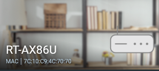

This link in aimesh node (RT-AX86U) not working.
Screenshot 2022-02-12 at 19-50-22 ASUS Wireless Router RT-AX86U - AiMesh.png
