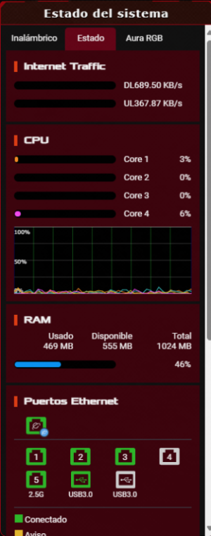

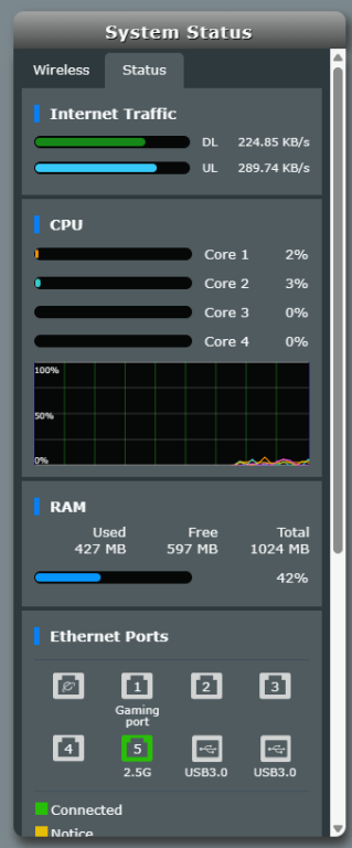

Anyone else have nothing displaying on the System Status section of the Network Map page?
No issues here on my RT-AX86U in AP mode...
Hi, for me work perfect in my axe11000. Try to clean cache in the browser,
Clearing cache nor trying different computers fixes the issue. Downgrading to Alpha 1 doesn't either but downgrading to 388.8_4 did. I've tested on a RT-AX58U, RT-AX88U and GT-AX11000 and they all have the same issue for me
works fine for me

Unfortunately the 1 RT-AX86U I could try it to see if it works on there, I don't have remote access to, so I can't verify if it works on that model but the issue is present for me on a RT-AX58U, RT-AX88U and GT-AX11000 running Alpha 1 and 2
GT-AX11000 Pro is now running 3006 firmware, so not the same firmware anymore as the non Pro models
So must be something just in your network, you try to reset and see if persist. Cuz to rare everyone have all fine but just u have all bad.
