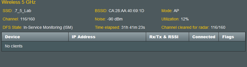

Wireless Log is not showing clients connected to the 5 GHz band. They are being correctly reported for the 2.4 GHz, 6 GHz-1 and 6 GHz-2 bands

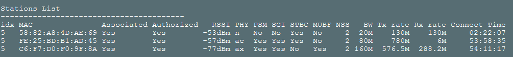

Low level details shows the 3 connected clients I would expect to see.
How long did you keep this page open? Sometimes it takes a few minutes to tabulate this log.
I did leave it open for quite a while I was troubleshooting, connecting and disconnecting clients to the 5Ghz SSID.
Changes were listed relating to this page and this is the first time I have seen it occur, so thought I would mention it. I may just reboot later and see what happens.

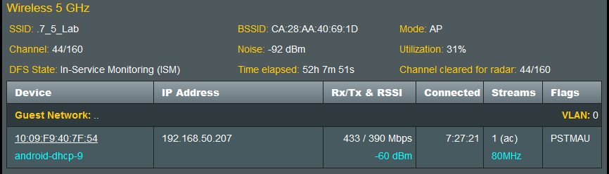

After updated to beta_1 on my GT-BE98 PRO from 3006_102.2_2, wireless log shows only two of my three 2.4GHz guest networks, even though the unshown network is there and working fine with clients connected to it.
I tried refreshing wireless log, cleared browser cache, disabled and re-enable the unshown network and reboot the router. None of that helps.
Works for me.
Anyone else with a GT-BE98_PRO?
Thanks for checking. The issue persists after reboots so if there is any data I can gather to help solve the mystery please let me know what you need. I should have time to try a factory reset this weekend if needed. As of now I have 4 connected clients to 5GHz and only one showing. I have not seen any issues with actual connectivity so just a cosmetic anomaly. 2.4, 6-1 and 6-2 are still showing everything just fine.
