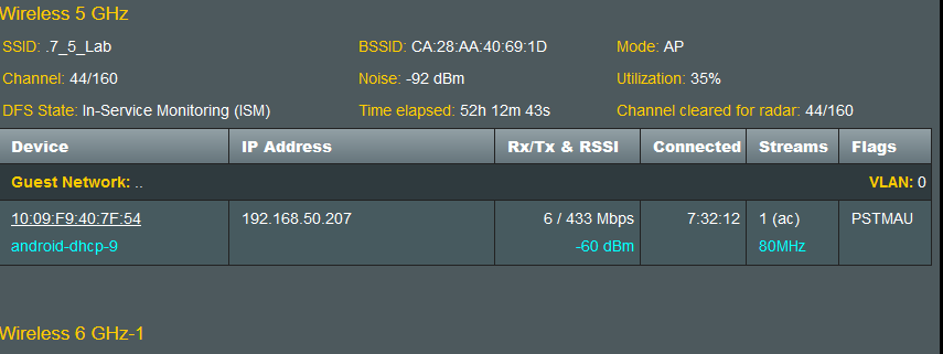

Thanks for checking. The issue persists after reboots so if there is any data I can gather to help solve the mystery please let me know what you need. I should have time to try a factory reset this weekend if needed. As of now I have 4 connected clients to 5GHz and only one showing. I have not seen any issues with actual connectivity so just a cosmetic anomaly. 2.4, 6-1 and 6-2 are still showing everything just fine.
How many guest networks do you have? According to the list, you seem to have at least 5 separate networks on that 5 GHz band, with three of these four clients connected to the 5th network. Are they all enabled, or are some disabled?
EDIT: the problem is indeed caused when you have multiple guest networks on a single interface - guest subunits are not always sequential. I'll need to see if I can get more info from Asus on how to better determine which interfaces to query.
Fixed with commit.
