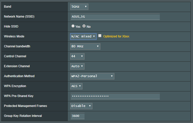

Bandwidth is set to 80MHz.

@krlkv Check what link speed you are getting, both on the router's System Log - Wireless Log page and the client's network adaptor. Also, try changing the bandwidth to 20/40/80. Try different channels.

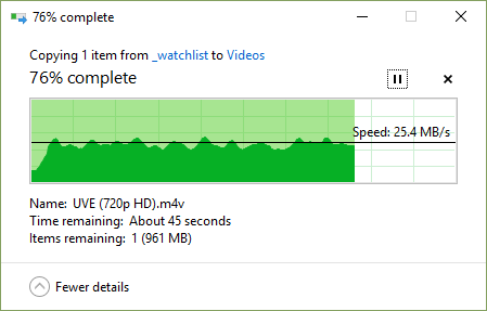

Wow, it seems to be fixed now. First time in 2 hours I finally see 25-30Mbps (twice what I got on N66U).
What did I do? Nothing really. First I switched channel bandwidth from 80MHz to 20MHz to verify that my speed dropped to roughly 4MBps (half of 8MBps that I was getting before with 80MHz, but my laptop card is 2x2). Then I switched back to 80MHz and suddenly it went up to 25Mbps.

Where were you copying the files to and from? Maybe it's nothing to do with the wireless connection. 25.4MBps (203Mbps) looks like its being limited by the write speed of the destination drive. You could try using a wired Ethernet connection (to the source and destination) instead to check what the maximum possible write speed is.
From Synology NAS (RAID 1) connected to the AC56U using 1Gbps Ethernet to my X1 Carbon laptop with NVMe SSD. This is what I always did to test WiFi speed. Both with N66U and today with AC56U. So no, I don't think read / write speeds were a bottleneck.
To give you an idea of write performance, if I simply copy file to another folder I get almost 1GBps write speed.
