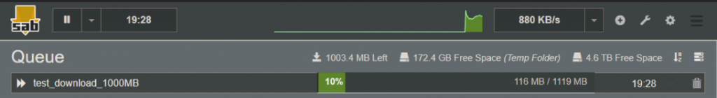

Finally, a test of downloading a test SABnzbd file.
SABnzbd self-test results.
The download folder is on an SSD, completed folder is on spinning rust. Sab has been given 4GB of memory cache.
Results of trying to download the 1GB test file.
The same file with the VPN turned on using a fresh portable install of SAB on a different machine. If I turn the VPN off, the results are the same as above.
