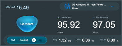

AC68U seems to "pause" internet connectivity.
xcarobx
I don't think the IP and DHCP connection with ISP is dropped but I periodically lose connection.
Very annoying when surfing, super irritating when on IP voice call or Zoom meeting.
I have used three different AC68U routers and it seems this problem is persistent.
It's been a problem for years I think, usually on the latest stable firmware.
I'm not sure but it sometimes seem like if I hit up google .com in the web browser I get traffic flowing again. :rolleyes:
Currently running Merlin 386.1.
Using a Lyra Trio as an AI Mesh 2.0 node. (problem has been with me long before this)
GUI is also quite slow to load but at least it's not as horrendous as it was a couple of years ago.
I've read of other people having the similar problems but haven't found a solution.
Considering trying other firmwares but I like the simplicity of AI Mesh.
If anyone has any suggestions I'd be happy.
