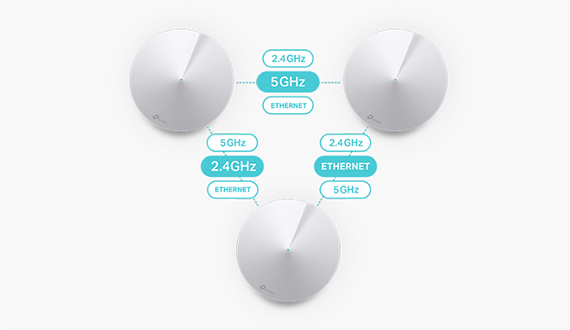

There is also several options for you a like a, Orbi Kit (set of 2) or why not a TP-Link Deco M5 (set of 3) cost half on the Orbi kit and is a "mesh" and with 1 Gb cable backhaul that can be done in a row "Daisy chain network", Orbi have to be in the middle as a "star network" and does not have cable backhaul it has a own 5GHz WIFI backhaul.
attachment.php
Deco is good if you can run a cable between all 3. If not the other 2 act as repeaters and cut your speed in half. For that I can get a $20.00 repeater.

Yes but i would go for my first point the 2 UniFi UAP‑AC‑PRO units and then just for the cheap mesh option the TP-Link Deco M5 in cable backhaul. (as i allready have switches in all of my rooms). Are you sure that they are acting like repeaters, its says the nodes talk to each other in 867 Mbps and you can ad more nodes to it?
It's tough taking advice from people as I have talked to so called professionals in networking and you get one story from one and another story from another. I spoke to a TP-Link rep and they said wireless they are repeaters and lose half speed. So it's better to have the Ethernet backhaul they said. Also got the info from Dong Ngo from Cnet. I take it he knows what he is talking about.
Aha OKi well i just tested them out at home but i was using cables from switches and therefore i thought they were APs as it was so they said to me.
I never tested them out without cables, it never hit me then do the resultated were so good.
Hate when they say one thing and later on it shows to be something else, like very bad.
