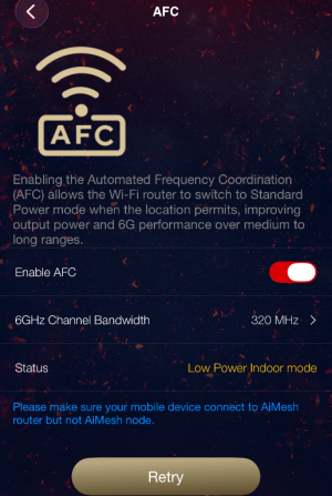

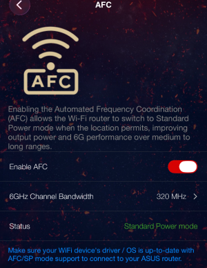

Yes, I tried it’s working very well. It switched from low power indoor mode to standard power.
I get ~2800mbps on my S24Ultra which is 600mbps more than without AFC. :)

I am having issues with my AFC not going into standard power mode do to a control channel conflict. I am on the 320Mhz width and have tried several different channels including 182 which has been a good channel to use for non interference. I have changed the router to auto on the control channel to see if this helps. Once I get home from work I will have my phone on the net to see if this changes things. If so then auto will be something I guess I will need to use. Would anyone like to share what control channels they have tried and got AFC to work?
Disabling/Unchecking PSC should make more channels available. (Turn it back on if devices can't see/connect to 6 GHz).
Try it from your cellphone using Asus router app. I had the same issue, but after toggling few times from my iPhone it started working.
I'm using auto and width 320Mhz, which sets to channel 37.

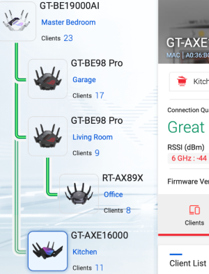

The wifi signal strength also increased by 18dBm with AFC, standard power mode, when connected to wireless mesh node.

Did it help with the wifi signal on the be98 pro? Mine would be in a wired mesh. I guess afc would only work on the main router and not on any of the be98 pro nodes unless I misread. I have two be98 pro right now.
No, I don't have another wireless mesh node. All other nodes are 10GBE wired, except this GT-AXE16000.
The reason for not having BE98PRO as wireless mesh node were indeed due to random disconnects every few days. So I moved BE98PRO to wired and using old AXE16000 as wireless mesh. This is probably a bug in BE98PRO firmware.

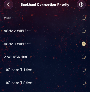

Thank you for sharing your AiMesh setup. You can control 5 GHz-2 on the GT-AXE16000 and 6 GHz-2 on the GT-BE98 Pros?
On AXE16000, I can choose either 5GHz-2 or 6GHz-1 for back haul. So if the 5GHz-2 is used for backhaul then the 5GHz-1 will be used for clients.
I’m using 6GHz-1 for backhaul as in the snap shot.

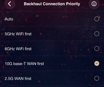

On BE98PRO, you can only choose either 5GHz or 6GHz as backhaul. You can’t specifically choose 1 out of the two 6GHz radios. See the second snapshot.
Much Appreciated Lax, Got home and went straight to the ASUS app on my phone. Toggled it off and on and after a 1 minute wait period all things started working as intended. I picked up another 20dbm of signal strength right away. -37dbm currently.
