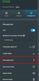

You can see inside your router settings that the printing method is not supported on the nodes. (attached picture)
