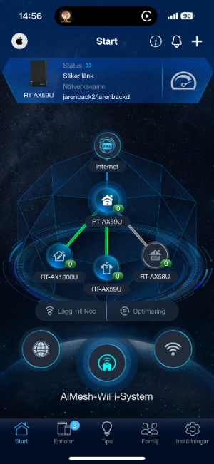

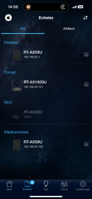

Hi all,
I’m experiencing a strange issue with the Asus Router app and AiMesh display. I’ve recently set up a new AiMesh system and everything works perfectly in real life—devices connect, internet is stable, and there’s no drop in performance. However, in the Asus app:
  • Some AiMesh nodes are shown as offline
  • Many client devices are missing from the list
  • Optimization and connection indicators don’t reflect reality
Here’s my current setup (all on the latest firmware as of June 2025):
Main Router:
  • RT-AX59U (located in daughter’s room, acts as main AiMesh router
AiMesh Nodes:
  • RT-AX59U (Ethernet backhaul, placed in closet on ground floor)
  • RT-AX1800U (Ethernet, placed in storage room with HomePod mini and Matter devices)
  • RT-AX58U (WiFi uplink, placed in attic, connected to PoE switch with 2 Aqara G5 cameras.
Note:
  • All nodes except the attic one and the outdoor Lyra Mini are connected via Ethernet.
  • The system was freshly installed with reset routers, manually assigned static IPs, and clean AiMesh pairings.
Despite this clean setup, the app UI is incorrect and misleading. Is this a known issue? Any workaround or reason this happens?
Thanks in advance!
Jonas
Pictures!
Update:
The network is now experiencing instability — devices occasionally lose connection entirely and require manual reconnection to resume functioning. This affects both wired and wireless clients, even though everything appears to work correctly from a hardware perspective. Could this be caused by outdated firmware?

Likely just another wonky network map. Long standing issue with Asus routers/AiMesh nodes. Time may fix it then again it may not.
Yes.
Should I update the firmware only on the main router, or all units (AiMesh nodes included)?
Nodes too. Just use latest ASUS stock on these even if Merlin is available. No advantage in using Merlin unless you really want amtm and Addons on your nodes.
