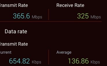

Happy for you but this is what I get on latest ax11000 pro firmwares… On the one from January I have 1400mbit upload and download.
Would you mind sharing your settings for wifi2 backhaul, both general and professional?
