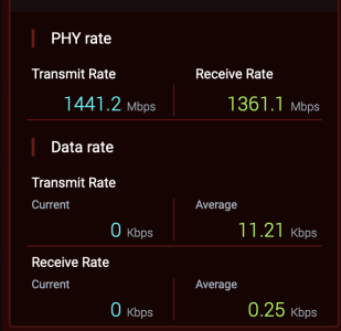

This is what I have after downgrading to 3.0.0.4.388_24199.

I tested wirelessly using iPhone and made sure I was connected to the node. iPhone would present the exact crippled speeds. I was able to get around 300mbits max on the newer firmware, while on the legacy one I was getting 600mbits or more.
